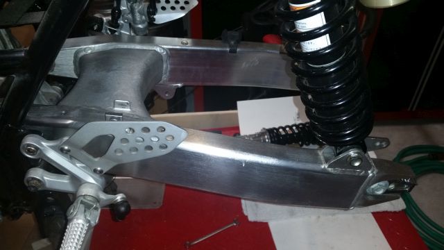

smurdoch wrote:
Spill it, JT.
What sort of project have you got cooking?
Nothing to special, want to adapt a CB400Sf swing arm to a 79 CBX. 79 Has a 14mm pivot bolt so go up to 15mm for the new swing arm.
[img]Image[/img]
JT in Texas

PostPosted: Tue Dec 27, 2016 4:42 pm Reply with quote Back to top
jt wrote:
smurdoch wrote:
Spill it, JT.
[img]Image[/img]
JT in Texas
Nice!
