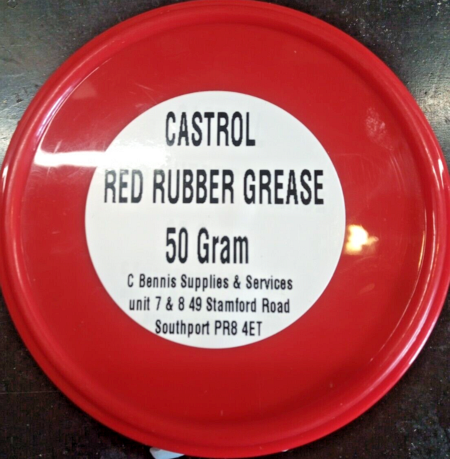

...the grease from above. CASTROL RED RUBBER GREASE 50 gram, BRAKE CYLINDERS, SEALS, O RINGS.
Some body grab s screenshot?
https://www.ebay.co.uk/itm/391674268813?chn=ps&norover=1&mkevt=1&mkrid=710-153316-527457-8&mkcid=2&itemid=391674268813&targetid=4585032215660911&device=c&mktype=&googleloc=&poi=&campaignid=554648192&mkgroupid=1302922387078119&rlsatarget=pla-4585032215660911&abcId=9323209&merchantid=87779&msclkid=bef9790bb4561cd2175f1cb9e240dd14

Posts: 11915
PostPosted: Thu Jan 25, 2024 9:19 pm Reply with quote Back to top
Interesting: greasemonkey
What is red rubber grease used for?
    Red Rubber Grease is used in the automotive industry in hydraulic and
    braking systems to protect & lubricate rubber bushes, seals and o-rings.
    It is also a good choice for use on brake caliper rebuild jobs. This grease
    compound is designed to preserve rubber and help prevent it deteriorating
    and cracking over time.    -Nov 30, 2019
Silicone grease can be used instead. I have food grade silicone grease I use. Scuba
divers (high pressure air line fittings), food prep kitchens, swimming pool pumps, etc.
use it. Works a treat on seals.
