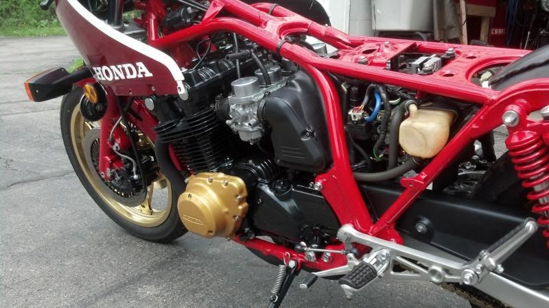

Finished mounting the motor, that took a while. Originally I fitted the swing arm pivot into the frame with a shim on the right side. The frame opening was wider so instead of crushing it down as I tightened the bolt I made up a shim. Now did the same thing with the motor. I pulled it too the left side of the frame and then shimmed all the gaps on the right side with fitted washers for a perfect fit. Don't know if it makes any difference but it appeals to my mechanical sensibilities.
All the covers are now back on, clutch, sump and oil filter etc. installed and filled with oil. Cranked her over till the battery got low to move oil around. Working on valve clearances now which are currently tight even for me!
Interestingly, I was looking at the R parts book and they show a shim / thrust washer on the right hand side of the swingarm ...

I actually did it in two steps. Firstly I shortened the swing arm pivot tube to take out any side to side play. Then I just kept trying washers of different thicknesses in the gap between the frame and end cap till I found one that was a tight fit. I did not measure it.

Been waiting on getting hold of some thin shims which arrived Friday so I was able to set the valve clearances and finish getting the motor ready to run this weekend. Before putting the exhaust back on I blasted the aluminum flanges and shot them with high temp clear lacquer, also blasted the collars and painted them with high temp silver and got new M6 nuts to bolt them home. The mix of colors is a little work of art all on its own.
So here she is just prior to me pressing the start button for the first time since rebuilding the motor. She came up first try.
So now I need to set the ignition timing, balance the carbs and adjust the pilot air screws.

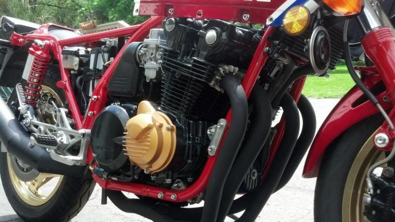

And done. Dragged out into the sunlight for final pics before putting the bodywork back on.
Then tank and seat back on gas and took her for a gentle 20 mile ride. Kept the revs down and the throttle light for now. All seems well and I am looking forward to giving her a good whipping once the new pistons etc. have run in.

Fuel cap arrived a few weeks ago and only just now found some time to work on my bikes. The cap was not perfect but in good enough shape to use and confirmed its the right part. So that is technically correct now.
Also did some work on the rear wheel. Here is the before pic
And here is the after
Other than cleaner as I took the opportunity to get some grunge off the wheel while it was out, it now has a proper R rotor instead of the F one I had on it. When I got the bike it had a custom drilled F rotor on it and I put on a 900F item as that was the closest thing I could find to original. Now bitter sweet Larry had an R rotor in his parts that Matt was selling and I picked it up. It needed to be resurfaced but is still above min thickness after I did that. Just a few more little details to get right and then she will be perfect.

The details are great Love it
DOHCRob
Joined: May 23, 2011
Posts: 817
Location: Hinckley, OH
PostPosted: Mon May 23, 2016 11:57 am Reply with quote Back to top
...except for the exhaust, Nick. Very Happy Very Happy Wonder why nobody has come up with a nice enough repro for these bikes.

I did not forget, I never heard of it. How do you get it? From what I see, it is a RB/RC repro. Not really for the RD?
I remember someone in the U.K. made a RD gloss repro once, but like the membership requests in the R club, all inquiries remained unanswered. Rolling Eyes
swiftnick
Joined: Sep 01, 2006
Posts: 1776
Location: Farmington Hills, MI
PostPosted: Mon May 23, 2016 1:55 pm Reply with quote Back to top
DOHCRob wrote:
Yes I am still looking for that as well.
Wout, please do share. What we see there treated to this gloss black plasma coating being talked about may be just the ticket.
