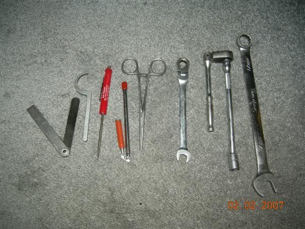

Here are links to some valve adjustment instructions and tools:
Shim Swap Video:
http://www.cb1100f.net/Other/misc/Shimswap.wmv
Humorous Procedure But Good:
http://www.cb1100f.net/modules.php?name=Forums&file=viewtopic&t=822
Valve Adjust Instructions with Pictures Conversion Spreadsheet:
http://www.cb1100f.net/Other/valvechart/papalukervalveadjust.pdf
http://www.cb1100f.net/Other/valvechart/papalukervalveworksheet.xls
Chart I created to record before and after shim sizes:
Picture of the tools for valve adjustments:
Dave
