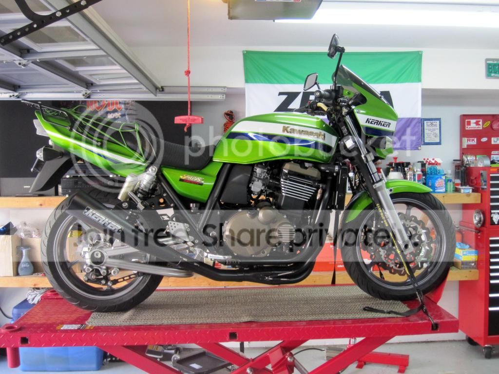

I got one of them to great bike.Not exactly stock.

Langys, I love the KERKER on those bikes. Here are some pics from the Stockbridge, MI a couple of years ago.

Your are right Chris Kerker looks very cool in my opinion.
