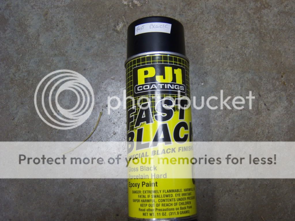

PostPosted: Mon Oct 01, 2012 10:01 pm Reply with quote Back to top
PJ1 Fast Black,, porcelain hard, epoxy paint,, my personal favorite, tough as nails
