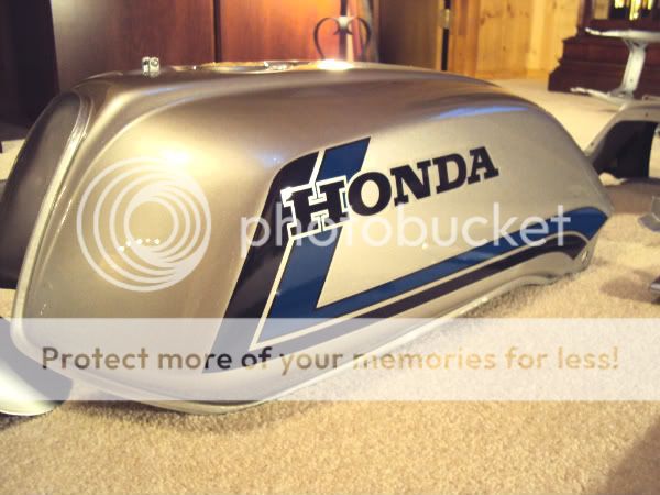

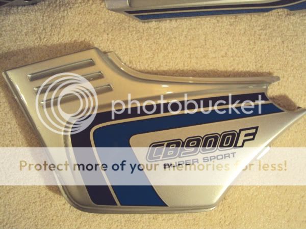

I have a silver 750 with an NOS tank from a 900. My painter was able to match it perfectly for the side covers, tail, and fender. I still have the can of paint that he used. Maybe the computer printed label can help? If not I can get you in touch with him. He owns a collision shop in Roseville.
Here's a pic:
