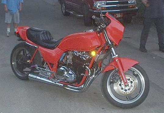

    I have owned the bike since 99. It was stock red when I got it (rough) so I bought some nice stock Blues then I decided to repaint the whole bike and this is the result. 0-100+mph in less than 7sec.
    11:1 comp.
    Port & polished head reshaped valves.
    Big cam 375 megacycle.
    Dyna 2000 ign dyna 2.2ohm coils dyna wires.
    Streched swingarm 7 3/4" over suzuki wheels (polished & painted).
    Dunlop d207 radials.
    Corbin seat.
    Pingel struts.
    MRE air shifter (not fitted in photos).
    900f forks with super brace (saves weight).
    36mm mikuni flatslide carbs (you don't see that everyday)
    Stock bottom end extra extra fun
