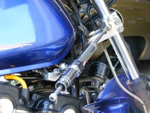

Please do show how the new damper is mounted, what kind is it and where did you get it. It would be nice to hear your impressions of the bike's behaviour with and without the damper.

I will try to get a pic when possible. As far as where I got it, it was right under your nose. http://www.cb1100f.net/modules.php?name=Forums&file=viewtopic&t=50056

It took me a bit to figure out the method and placement of the steering damper. Regardless, I figured out a placement that gave me both full movement and clearance. I just wished that I could've mounted a similar small one like this on my Bandit.
